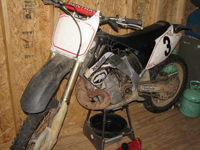

This is the most recent pic I have of the bike.
