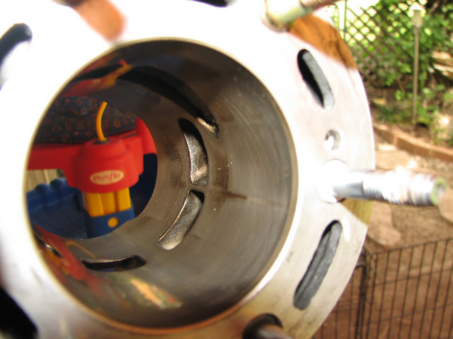

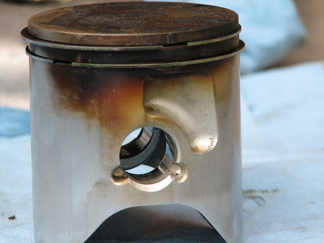

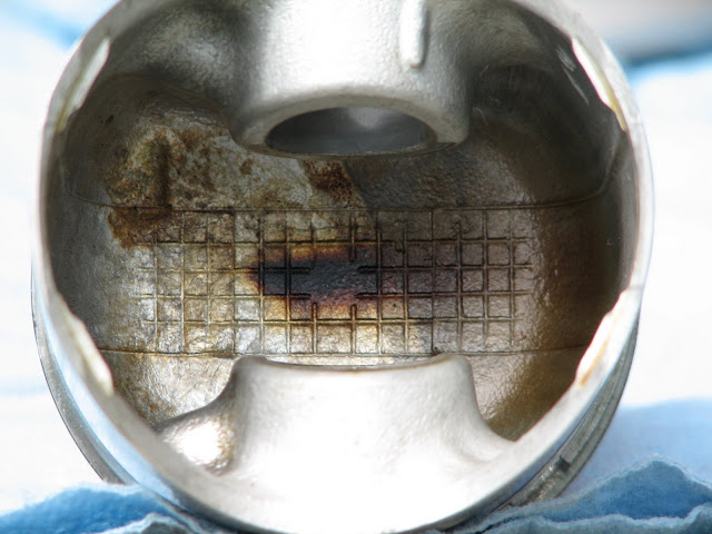

Took the top end apart today, everything seems to be ok. I wanted to post some pics to see if it appears that my cr was running too rich or not. Also, I can see a few shiny lines in the cylinder, and want to hone but need to know if I just do the scotch-brite or brush hone? Where can I purchase a brush type hone? Thanks for any help. I am replacing with a wiseco piston and new gasket kit.

It looks like that piston was getting a little too hot. I think that is an indicator of it being too lean, but dont quote me on that.

I've posted plenty on this bike here in years past. The '03 was a good bike and there is really little you can do to make it great. The stock carb and jetting didn't seem to work anywhere except sea level, so you might be okay there. While you have it apart I would turn the base down and raise the exhaust port to help broaden the power spread. The stock pipe is a great performer and there isn't much, if anything to be gained by switching. About the only reason to switch would be to replace a smashed or folded pipe. The SST will get you some noticable power but is a tuning headache IMHO. The stock reed cage is adequate and capable, just keep fresh reeds bolted to it. The head could use a tighter squish band and bit more compression, but if you machine the base you'll already get this one. The big-bore options are not reliable if you plan on keeping the bike more than one or two seasons. Been there...
As a rider, father, and ex-CR250 owner you'd be in good condition with some minor cylinder work (as mentioned), keeping the piston/reeds fresh and saving your money for tires, suspension and practice fees, IMHO.
